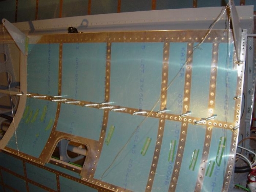

Long day today!!!! - Finished the DDD (dissassemble , deburr, and dimple) of all parts, Primed the wing skins and the stiffeners. Began riveting the inboard skin on the Left wing. This is a little ackward, and goes slower than other rivet jobs, I was able to get to all of the rivets without any help. Took it slow and finished 1/2 of the inboard skin tonight. I need to finish the rest tomorrow and Fri. so that I can move these to a hanger on Sat.

Used some safety wire to hold skins away from the structure
