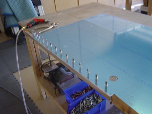

Fabricate the construction angles. The plans don't say which piece to use and here's where I got a bit crossed up. I used the .063 stock and after drilling and clecoing it and beginning to put the bend in it became quickly apparent that this was too thin of a material, so, remade the construction angles out of .125 stock

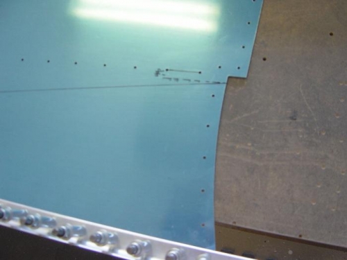

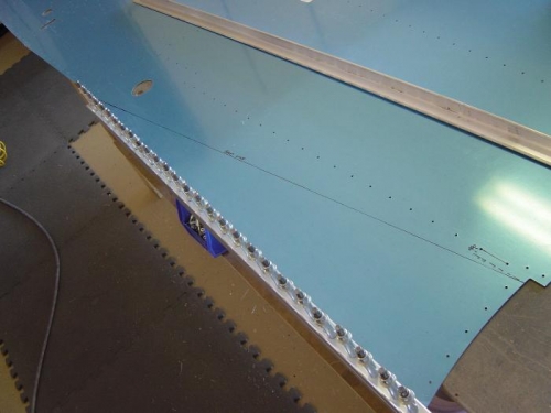

Draw the bend line
Draw the bend line
Drilling the construction angles
Ready to bend
Ready to bend
