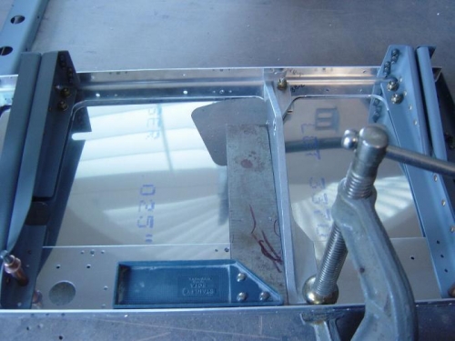

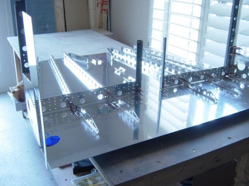

Continue preparing parts for the Fwd fuse and bulkheads. Match driled the AN3 bolts holes on the control colimn assembly. Match drilled the remaining AN3 bolt holes on the F1048. Clecoed the fwd fuse floor ribs to the fwd fuse bottom skin. Match drill all #40 holes
Match drill the control column mounts to each side
Add more parts for match drilling
Match drill everything in this section
