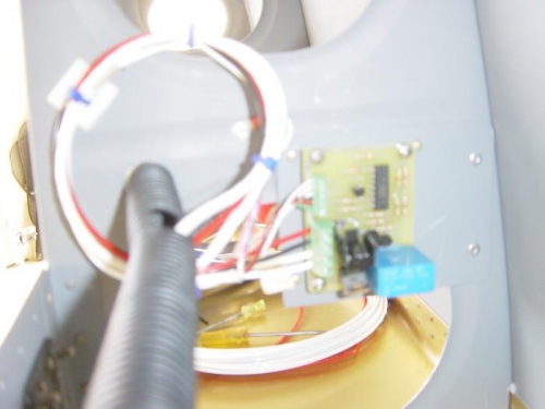

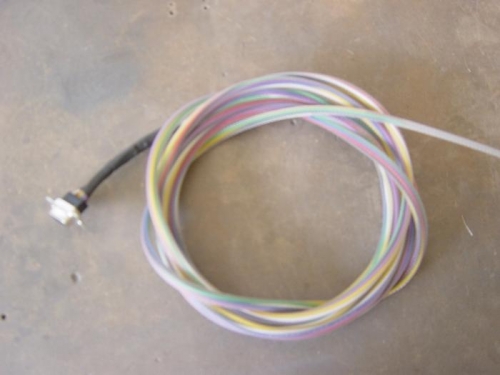

Woked some more on the Wiring for the wings. Fabricated the roll Servo harnes and installed it through the conduit and attached to roll servo. Also connected the pitot tube and ran the wires through the conduit for same, including the LED indicator cable. Ran the shielded strobe cables through the conduit and installed the connectors on the wing tip ends. I need to get an AN fitting tomorrow am so I can connect the nylon Pitot line i got from SafeAir. Also will run the wiring for the Duckworks lights and install the power pucks for the LED position lights. After that the wings should be ready to button up after a Tech Councilor visit.
Made Roll servo cable w/ D-sub connector

Gretz heated pitot connections
