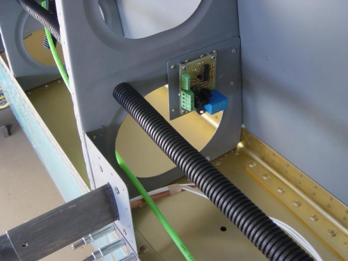

Finished off the Pitot tube installation, match drilled (inside out) the #19 holes, took skin off, and cutout the opening in the skin that allows the pitot attach bracket to pass through. riveted the pitot attach bracket to the rib, TruTrak roll servo arrived via UPS today, so installed it. No instructions, only a color picture and bags of parts. I think I've got everything in the right place, I left the control arm loosle attached intil setting up the final linkages and adjusting ailerons and torque tubes for final. then installed the Heated Pitot control module, it neds to be instaalled close to the pitot tube, so I made an attach plate from .032 scrap and riveted it to the rib, the used nutplates and some lp4-3 to attach the plate and the module to the adjacent rib. A lot of time consumed on what should have been fairly simple tasks.

Heated pitot control module riveted in place
