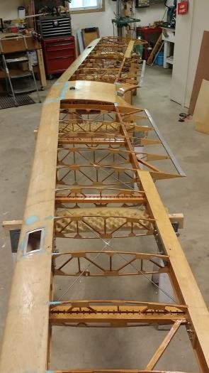

Date:  5-10-2014
Number of Hours:  18.00
Brief Description:  Upper Wing Covering
I have been preping the upper wing for covering by filing and sanding the areas around the LE and the tank cover. Installed wire attach fitting plates, hinges and upper wing access panels (Fabrication and fit) I had a pre cover inspection completed without issue by our EAA technical Advisor. Dad helped me cover the upper side of the upper wing. Started shrinking one bow.
