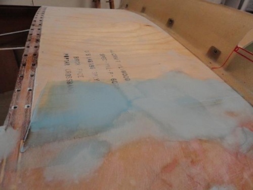

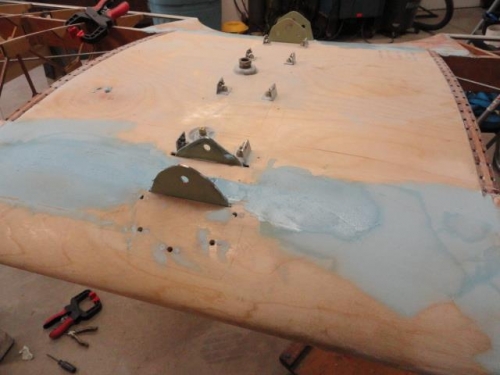

Filled and blended areas around the joints using super fil to make good transition across joint. Prepare and intalled 6 hinges for upper wing. Torqued to 25 inch lbs. Polished hinges and cleaned before installing. Torque seal applied.
