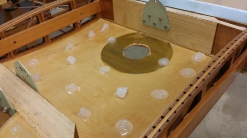

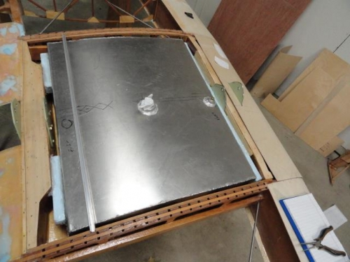

zInstalled center section fuel tank in the upper wing. I applied 10 or 12 dollups of clear pure silicone and while still wet, set the tank in and pushed down to make sure all areas of tank surface made contact; installed foam and affixed in place with silicone adhesive. Installed 5 nut plates in LE to attache the LE of the canoe.
