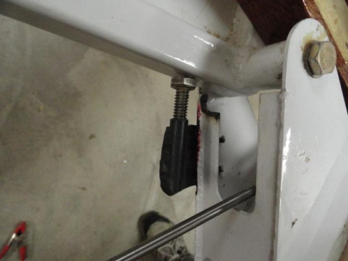

Aileron Stops
From some 4130 sheet I fabricated an attachment plate for each of the aileron travel limits; I then welde a piece of tubing and drilled and tapped for 1/4-28 bolt to make adjustable. Match drilled for attachment to the bell crank block
