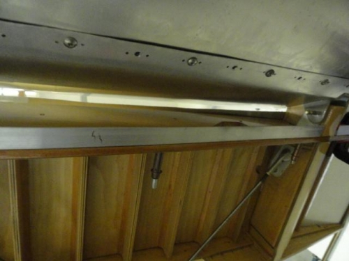

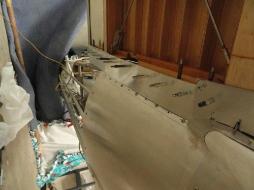

Wing Root fairing
Fabricated under wing fairing from .032 sheet aluminum; Using aluminum angle, I shrunk to match camber of lower wing; this attached to the root rib.
