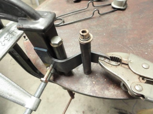

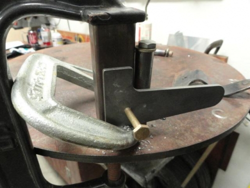

Slave Strut Bracket
Layed out jig for bending the water jetted pieces by using square tubing clamped to 3/16 sheet of scrap I was given;driled holes for accept 3/8 pieces of tubing around which the pieces were to be formed with heat.
