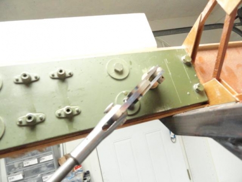

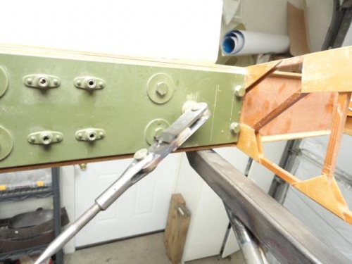

My upper wing rear flying wires were too short so I fabricated two extensions each 3.063 center pin to pin by sandwiching a 3/16 piece of 4130 sheet between two pieces of .125, I then drilled and reemed for 3/8 pins. See drawing.
