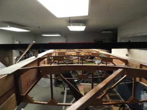

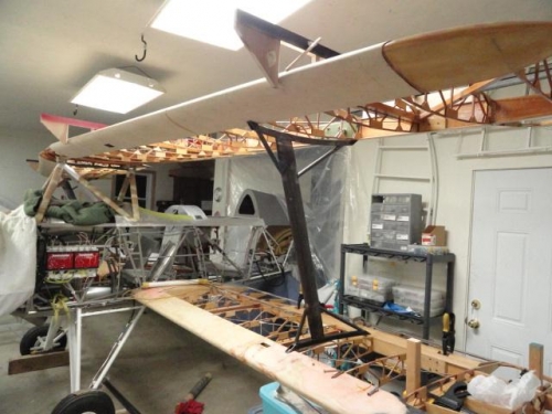

Fabricated 3 sets of spar plates from .125 2024 aluminum, reamed and fitted for install; installed welded I Struts and removed supports; checked for good rig with boards
Rigging boards in place show good rig with no washers.
