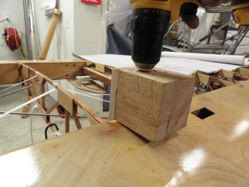

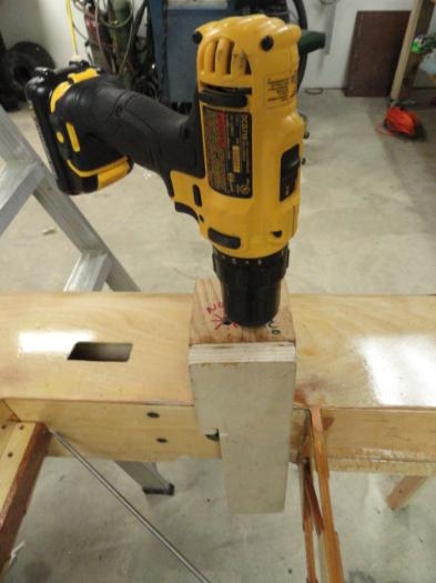

Made drill jig to drill front and rear spars for I strut attachment from oak block. Installed drill bushings; laid out hole posiitions per plans; began drilling spars for I struts

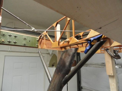

I cut the top support square tubing from the lower I strut.
