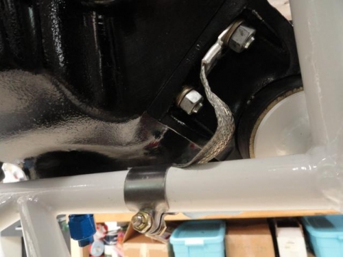

Made up a bonding strap from engine mounting lug to the engine mount frame. I removed the epoxy from the mount frame for about 1/3 diameter of the tubing and applied dilectric grease before installing the tubing clamp. The lug was crimped and soldered.

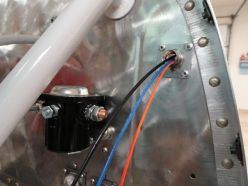

I purchased a firewall fitting that is supposedly a fire break. Installed and mounted to firewall. 1/2 inch diameter
