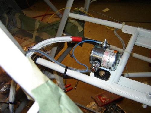

Wiring
installed battery solenoid. made up cable end with copper lugs and terminals. Wired in strobe, starter cable, ground for solenoid. Wrapped in spiral wrap for abrasion reisistance. Installed cushion clamps to support all wires.
