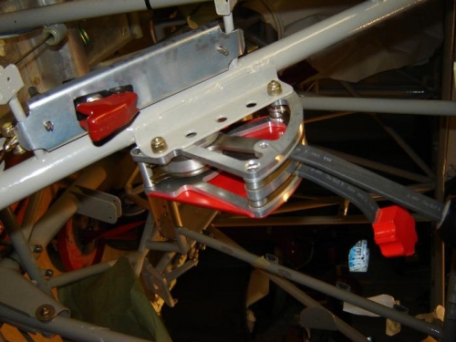

Instrument Panel
Constructed a subpanel for left side of a/c to accept smoke switch and switch guard. Using some .32 alum sheet and made the panel 2 inches wide and bent 1/4 legs to stiffen. These were attached to the 1/4 standoff tubing via cushion clamps -4.
