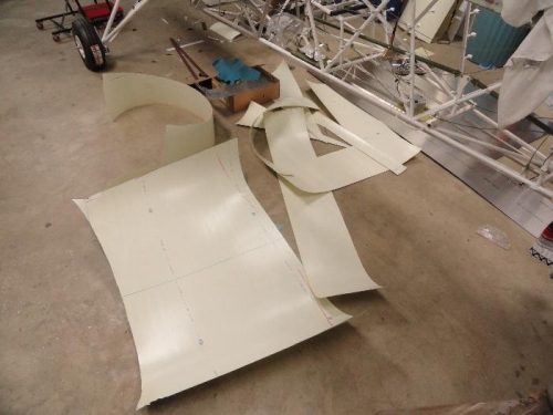

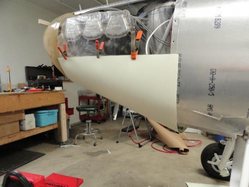

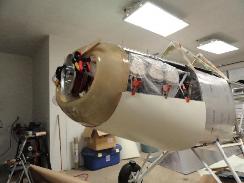

The first pattern was far from satisfactory, so I used some butcher paper, which worked poorly. So, I went back to the first pattern and cut and pasted patches to match radii along nose bowl and firewall. I then cut and trimmed that pattern. I used it to make pattern #2 and it worked very well. I clamped in place and trimmed to fit for the making of aluminum lower nose cowl.
Pattern carcusses
Pattern carcusses
Pattern #2 in Place
Pattern #2 in Place
