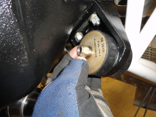

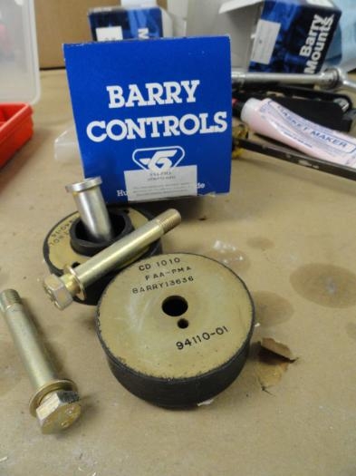

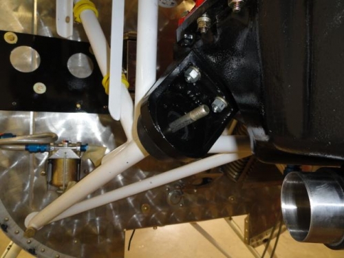

Installed lower mounts which took a bit of effort. The holes were not perfectly aligned so I had to use a "bullet" and drive it through and follow it with the bolt. The bolts were AN 7/16 27 Bolts. I torqued the isolator bolts and airframe to dynafocal mount to 255 in lbs.
All new mounts and hardware
Install of nut on lower mount
Lower mount bolt in place
