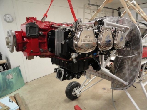

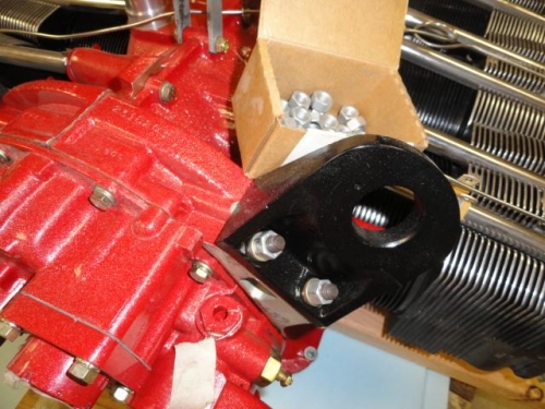

Brief Description:  Engine Install
Prepared Air dynamics sump for mounting. Used a new gasket and some Continental Gasket Sealer as well. Finsihed installation of engine mount ears; reamed bolt holes for engine rubber mounts; installed sump and induction box; Installed top bolts and isolation mounts from Barry.
