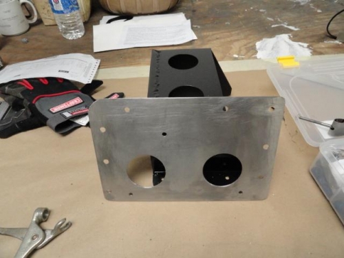

Using some .063 sheet 4130 I made a plate to support the battery box to the firewall. I drilled two lightening holes and match drilled the fastener holes. Still needs paint tbut its too cool to paint. til tomorrow.
Battery Box firewall plate
