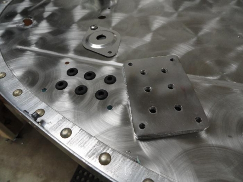

I received the synthetic grommets and installed them after opening the holes in the firewall.

Firewall through block
