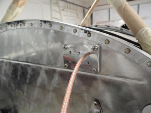

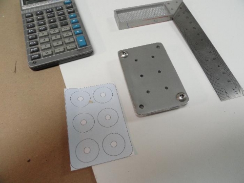

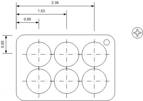

I need to run through the firewall 6 high tension leads to the coils for my electronic ignition. So I fabricated a plate consisting of two .125 aluminum pieces 2x3. In one, I drilled out a 7/16 hole to accept a grommet to in turn accept the lead. Simple but works well.
