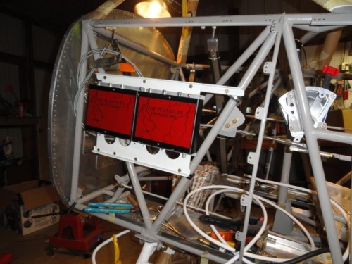

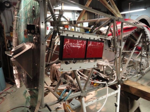

Install Electronic Ignition Modules
Using some 3/4 aluminum angle and 4 adel clamps I fabricated attach strips to attach the mounting plate to support the electronic ignition. Then painted
