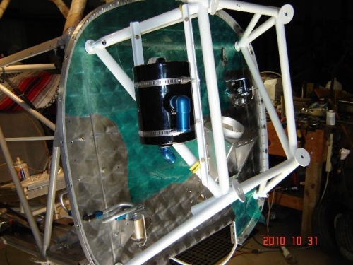

Brief Description:  Engine Prep

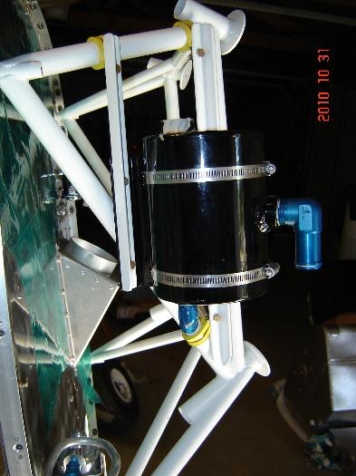

Completed final assembly of slobber pot mount for inverted oil; I used some 3/4 angle aluminum, and 1 inch adel clamps to attach to engine mount. I had previously attached the pot to the firewal but felt that the pot should be higher so that it will drain out quickly.
Also started work on building a mount for the Lightspeed Electronic Ignition System. I used som .070 aluminum sheet and began driling out lightening holes
