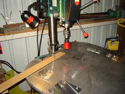

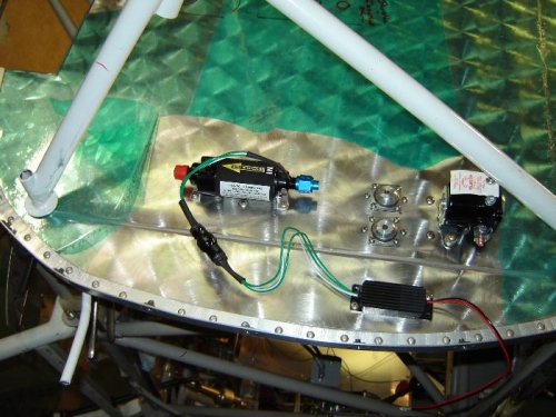

After MUCH planning and consternation, I layed out the location and position of the items to be hung on the firewall. Using some .090 aluminum I fashioned reinforcement plates that are attached to the back of the firewall.
Fuel Pump, eyeballs and solenoid
cutting 2 inch hole to accept cabin heat box
Cabin heat box in position
