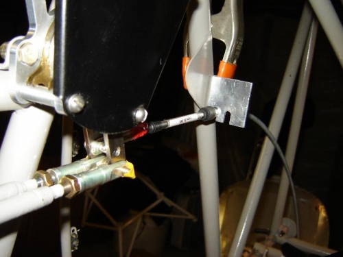

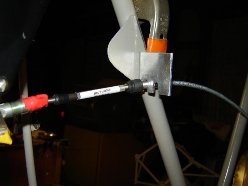

Brief Description:  Throttle cable stop
Using some .125 alum plate, I cut it 4 x 3 and on the brake bent it in the middle (short) to 90 degrees. I then drilled two .250 holes 3/8 inches apart and cut slots to the hole to accept the control cables from the throttle quadrant. On the cables there is an attach point that has a .250 diameter and .125 wide. I filed the slotst to .255 and they snapped in placed.
