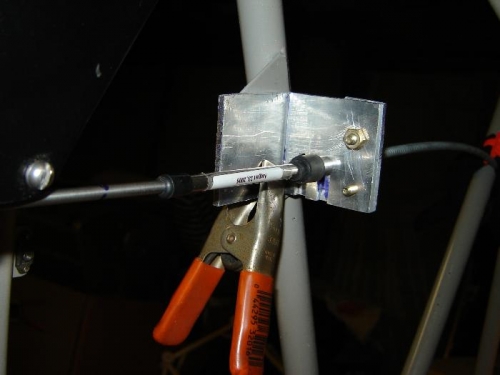

Throttle cable stop
Layout and fabricate cable stay to attach cable stop. Use 2 3/16 4A bolts to attach cable stop to cable stay.
