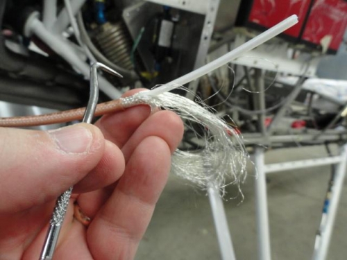

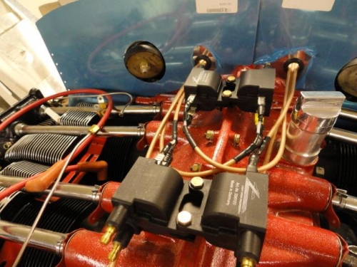

For the electronic ignition, I stripped the six RG400 coax cable. To use the braided shield as a twisted conductor, I used a dentist's pick and pulled apart the braid back for about 2-2.5 inches. I then twisted this. I then stripped back the center conductor insulation. I applied good quality terminals and applied heat shrink in copius amounts. These terminals connect to the coils on the Lightspeed engineering
