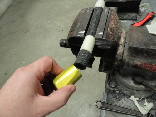

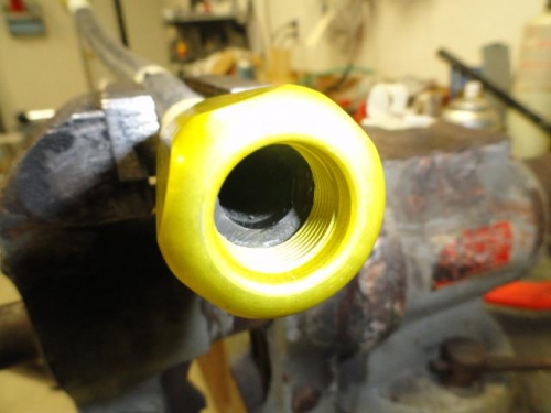

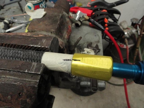

Brief Description:  More Oil Hoses
Made up last end of the hoses, This hose feeds between the shuttle valve and the vac pad for the inverted oil system. All oil hoses for the inverted system were made up from 303 -10 hose. Oil cooler hoses were also made up with 303 but they are -8. Stratoflex 156 hose was used for the oil/air separator to the exhaust evac system
