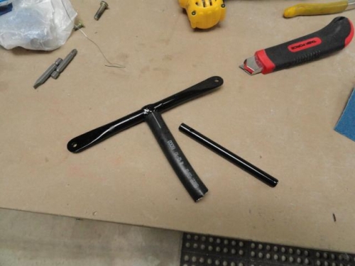

Fabricated an exhaust hanger by using a piece of 4130 round tubing, flatening both ends and drilling holes in the flats for a #10 screw. In the center of the that tubing, and 90 degrees to the flats, I drilled a hole to accept 3/8 piece of round tubing about 3 inches long. I then welded the two in a 'T' shape. The flatened tubing will be attached to the engine mount via adel clamps. A piece o hose 6000 3/8 will be attached with hose clamps to connect to a piece of 3/8 4130 tubing that is attached to exhaust collector.
Attached and torqued oil return lines.
Exhaust Hanger
Exhaust Hanger
