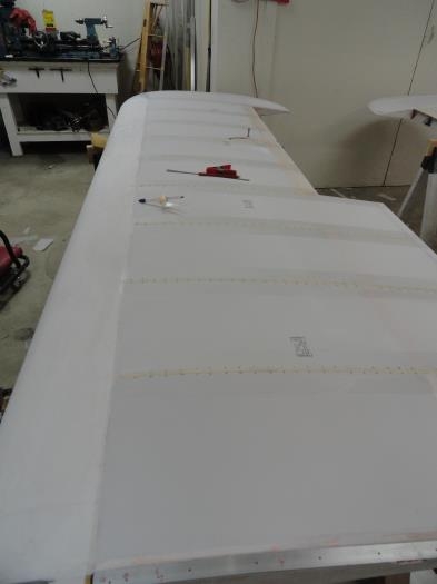

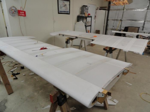

Covering Wing
Finished stitching left lower wings and prepared for rib tapes by cleaning and applying two coats of thinned adhesive. Each wing took 255 stitches or about 30 hours in actual stitching of both wings.
