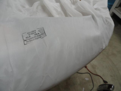

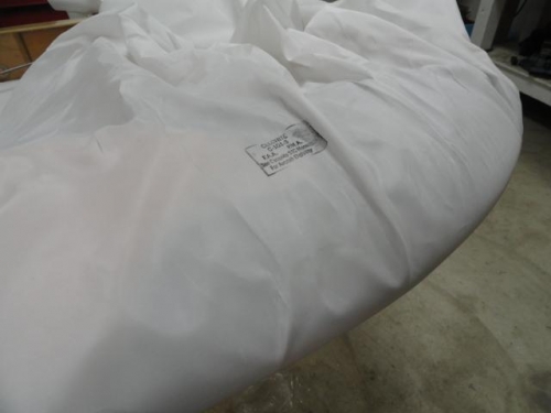

Started shrinking on left wing. Basic layout with perimeter adhesive applied. Installed brass nut inserts in wing walk for wing fair.
Pre shrink
250 degree shrink for half hour
300 degrees No adhesive
