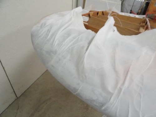

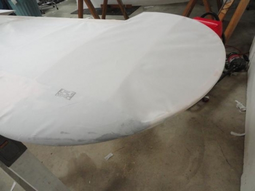

Started shrink forming the leading edge and bow tip. Image one shows the point at which I started heat forming the area where the leading edge blends into the bow tip. Lots of pulling, ironing, and 2 hours later, I got what Image 2 shows. Trimed excess fabric all the way around and ready to tauten the fabric within the bays.
