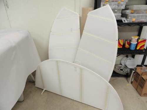

Covering Tail Feathers
Cleaned up all tapes with iron and Acetone. Ensured that all tape edges were heat sealed with Iron at 250 Degrees. Finished horizontal stabs and rudder ....ready for primer and paint!!
Started the process of stiching elevators.
