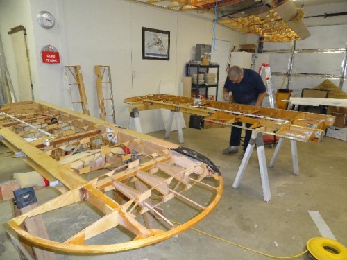

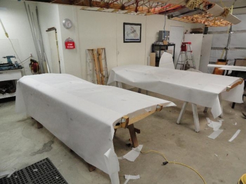

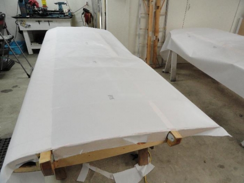

Routed overhang of leading edge material flush with rear of spar; filed with radius; finish prep work on lower wings; Applied two coats of adhesive thinned 2:1 per direction; layed out underside of wing fabric; glued butt end
