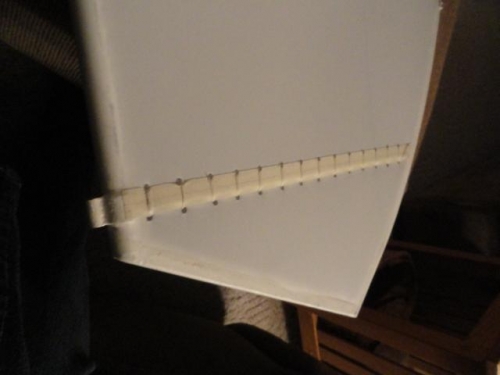

Covering Tail Feathers
Laid out holes around and along ribs in Right Horizontal stabilizers by heat forming holes with electric soldering iron; Began stiching at 1 inch intervals using Superflites hidden knot method. Finished right stab.Ready for tape.
