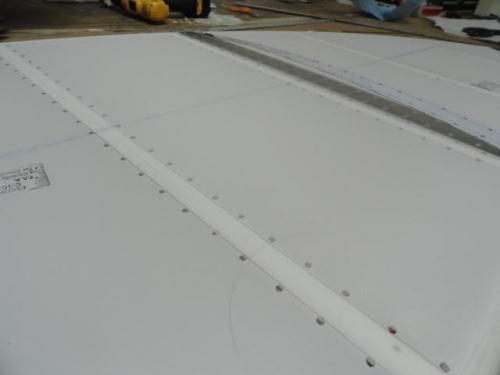

Brief Description:  Tail Feather Covering
Final coat of adhesive 4:1 on all glued surfaces. Final heat form all surfaces; Fabricated a guide for layout of holes to sew at ribs; Using a small electrical soldering iron to make 3/16 holes 1 inch apart. Taped each rib with reinforcement tape and began sewing the right horizontal stab
