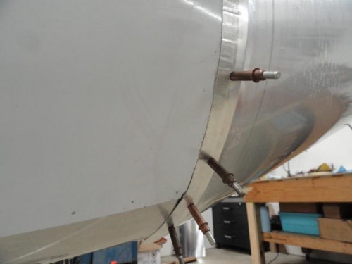

Thinking about it, I realized that a second break forward of the screw line and about 1.25 inches from the edge would work best when it came to shrinking the edge of the cowl. So, using the joggle tool again, I made the second break. Then I began the shrinking process very conservatively because the 3003 .032 will pucker again by the shrinking process. The process worked really well the fit is very tight.
Shrinking in progress
Post shrink
Post shrink
Post Shrink in place
