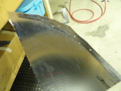

Number of Hours:  1.50
Brief Description:  Engine Cowl
Finished match drilling the new cowl to the firewall flange. Using a joggle tool, I broke a slight angle along the rear of the cowl where it passes the firewall flange. The offset was at 3/4 of an inches. This left a pucker every 3-4 inches which needs to be shrunk.
