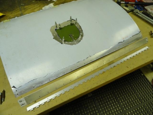

Date:  6-10-2011
Number of Hours:  2.80
Brief Description:  Engine Cowl
Decided to use AD protruding 1/8 rivets to attach top center cowling panel to the stiffeners. So, re-drilled to 1/8 all of the holes on the left side of panel and began bucking rivets. Match drilled holes through Nose bowl and firewall to accept stiffener and screws. Re-installed nut plates.
