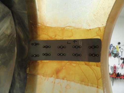

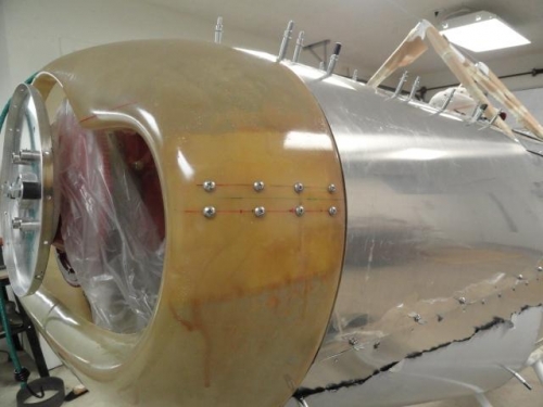

Counter sunk and riveted backer plate with 8-32 nut plates. This plate will support the split line for the nose bowl
Screw over backer plate
Inside Cowl view of backer plate
