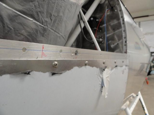

Date:  5-29-2011
Number of Hours:  5.00
Brief Description:  Engine Cowl
I added an additional .025 shim to the stiffener rail between the firewall and engine nose bowl. I then layed out and match drilled the hoods to the stiffeners for installation of 1/4 turn stainless camlocs. I then installed one SS receptacle. I also layed out and installed nut plates to attach the lower cowling to the stiffener.
