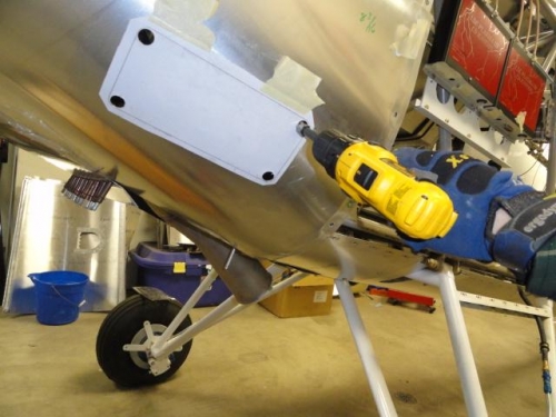

With the pattern gled in place, I drilled holes in the corners. I then used a jig saw to cut along lines to make vent hole. Filed to lines. Scribed line along edge of opening and drilled holes to accept 1/32 rivets. Both sides completed and ready to rivet
Drill Corners
Drill Corners

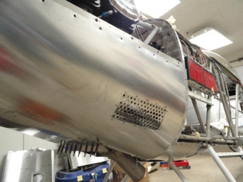

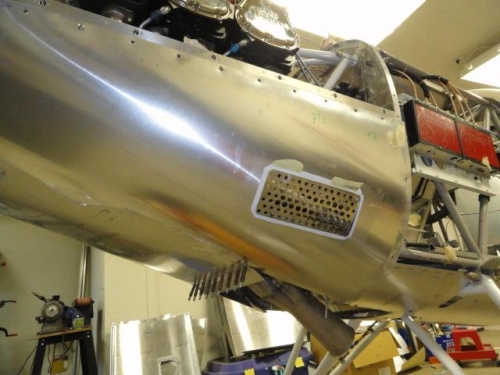

Grill vent taped in place
Clecoed in place
Clecoed in place
