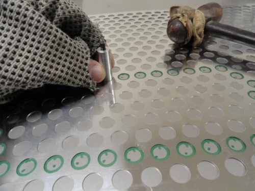

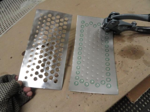

Fabricated second engine cowl cheek vent. Created cut out pattern for vent via Delta Cad program, printed it and glued it in position on cowl cheek using elmers clear school glue; fabricated lower cowl vent air deflector from .032 6061 material, drilled holes and clecoed in place
center punching SS per patern
Punching holes
Punching holes
