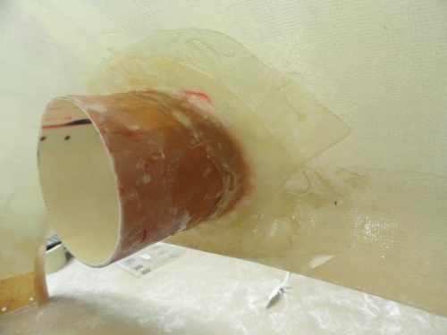

Brief Description:  Engine Inlet
Spent some time positioning the inlet tube at such an angle to be only a slight off from the injector body, Taped in place and checked alignment in place. Began laying up fibreglass with 2 heavy weight 2 x 6 inch approx pieces layed over one another. Then reinforced with two more layers of lighter weight blending between the tube and the back of the bowl.
