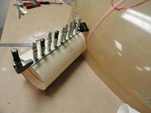

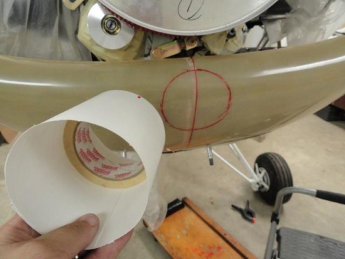

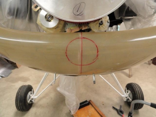

Brief Description:  Nose bowl inlet
Re installed lower have of nose bowl and located position for the inlet to be made in the lower half. Began making a tube to be fiberglassed in the lower half for a flexible hose to be attached between it and the injector. Using some heavy fiberglass stock I rolled and glued with 3m to make the tube that I will fiberglass into the lower half. Held in position with numerous clecos.
