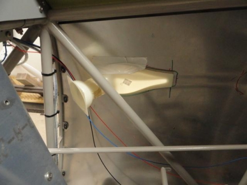

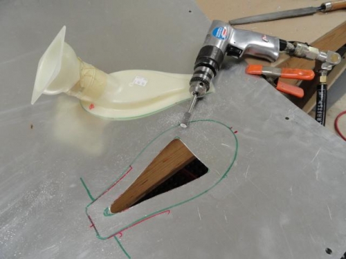

Set up second NACA inlet. This one is for the left side. Used the same pattern to layout. Cut and filed opening. Adhered with 3M epoxy and flush rivets.
