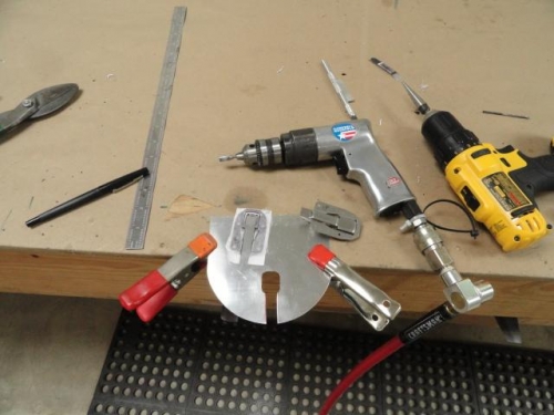

Started install of spring latch on Oil filler door. I scanned the latch into the computer and printed out 1:1. I then cut out and glued to the oil filler door. I then cut along the line and roto-filed to fit. Drilled and readied to rivet to door.

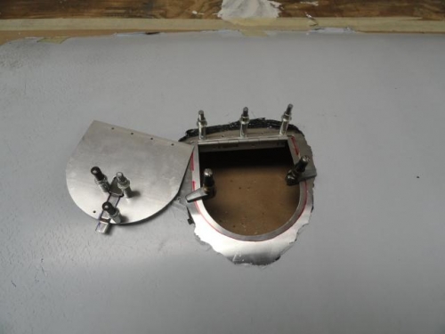

I then laid out the oil filler door jam with .032 to match radius of door opening.
