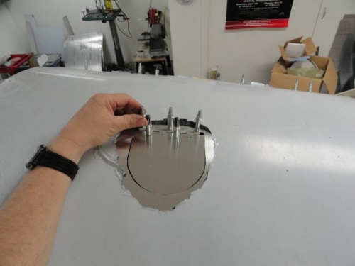

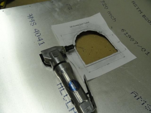

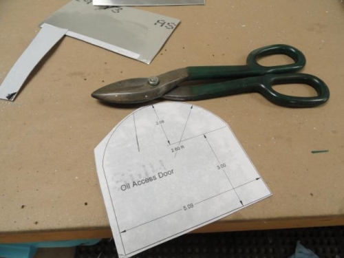

I drew and printed a 1:1 of the oil filler door and cut out in the top center engine cowling panel. I then glued them to the aluminum to be used with elmers school paste and squeegeed out the access. Once dried, I cut to the line and file finished. Using some -3 extruded hinge I fitted and drilled to panel and door.
Oil Filler Door
Oil Filler Door
Oil Filler Door Cut out
Hinged and in place
Hinged and in place
